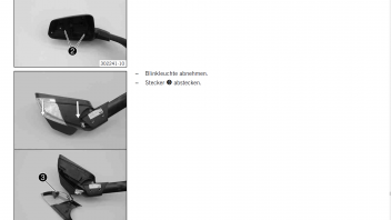

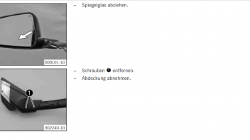

This is the chapter from the (german) user manual:
